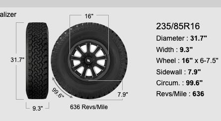

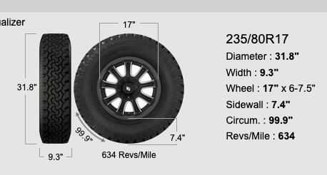

Curious about wheel spec. What bolt pattern and offset is it? Also, can the end user adjust speedo/odometer calibration for change in tire size? OTA update from your phone to adjust in app would be an amazing feature!
